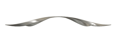

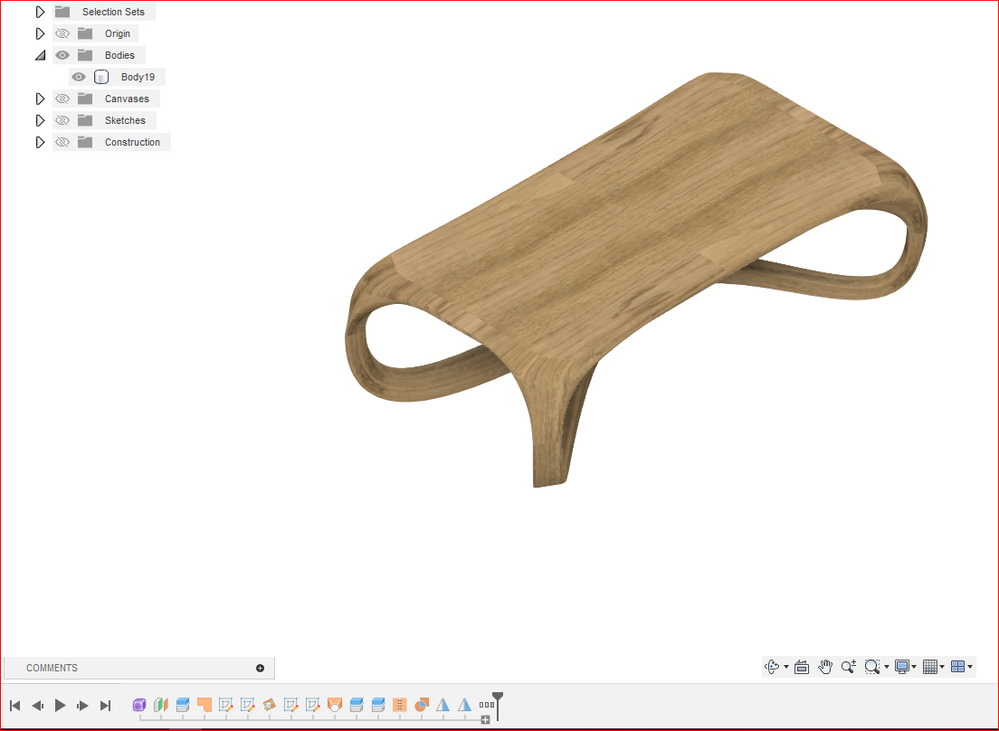

I have a model for a table that I quite urgently need to present. My 3d model is still very flawed but the smoothing function does not work as i want it.
The 2 legs that sweep and twist underneath should look the same from a side view (looking at the twist) but from a front view I want the 2 sweeps to come together and then separate again.
I attached how i want it with some veneer strips to give an idea. And also the flawed model where the connection is not yet made.
Since i need to model it urgently, all help is very welcome.
Thanks in advance.

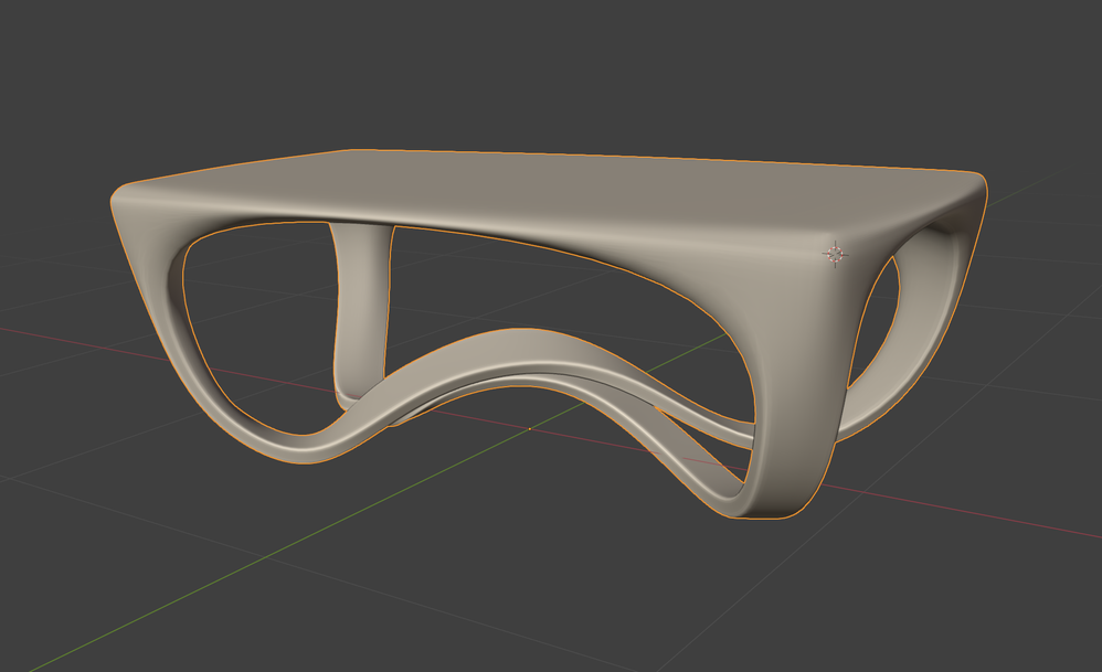

sI am getting there ...
While this can be done with Fusion, obviously, I am not using Fusion for this, but Blender.
When done, I'll transfer this into Fusion.

Is this getting closer to the shape you are looking for?

the shape of the tabletop and the legs going down is actually looking quite close to what i'm making when looking at the model of @davebYYPCU
but the way they intersect in the middle is effectively the way you are modeling it in blender. the only thing is that they don't sit on top of each other. ( When the client appoves) I'm going to join them where they come together and then they separate again. But you captured the flow effectively

How is this?
Message 15 of 47
ruben_van_lerberghe
This is amazing, really close to how i want it.

Yes, but there is one caveat. I have applied weighted edge creases in Blender, which helps round over things. In Fusion, a crease is sharp with no weight.

The small model you imported in the end, is exactly that, a small model on a 1:4 scale. The top of this model has been approved by the client, so ideally i would conserve that, combining it with the leg structure you have modeled ( the large one)
If you think it's better to stay in Blender until finished, I can try this as well. I don't know if its a big learning curve.
