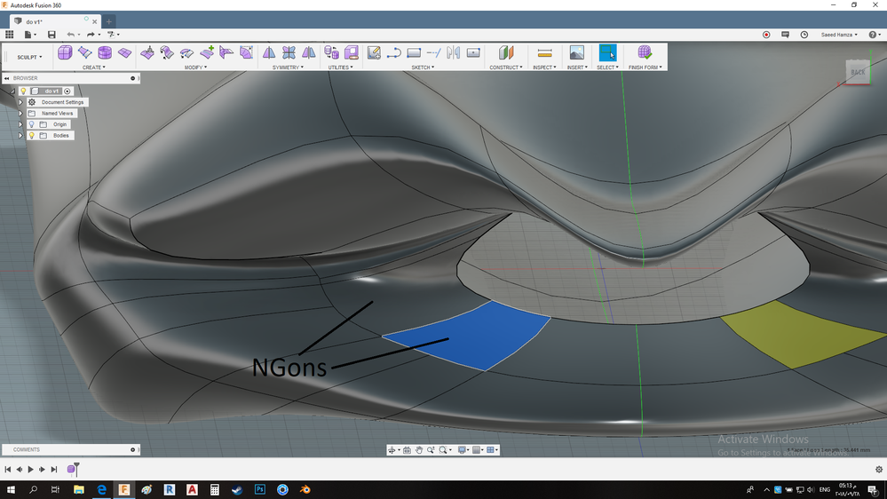

You have many issues to solve 1st
1- You have many NGons ( faces with more than 4 edges ) in your model, which is a really bad thing to have in your geometry
2- Use the box display more to see the issues that you can't see using the smooth display mode
3- Edges not continuous, which creates more NGons
