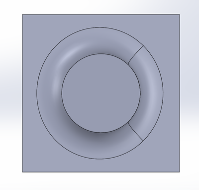

Please someone explain to me how to replicate what I created in SolidWorks in Fusion 360.
The model in SolidWorks:
The model in Fusion 360:
Fusion 360 distorts the upper face on the model so it is no longer round while SolidWorks doesn't do that.
I attached the f3d file.

Message 5 of 13
algor_neil
Solidworks has options of "keep edge" or "keep surface" for overflow fillets like this, you need keep edge to prevent that face getting distorted. Looks like 360 is using keep surface.

chrisplyler
I don't understand the desired geometry.
If the angled fillet is uniform, and basically you're cutting the cylinder off further down into the fillet on one side than you are on the other, then of course the cut-off surface is no longer going to be a circle.
Also the base of the fillet isn't going to be a circle either, since it's on an angle relative to the cylinder.

vid.kok
The part that I attached in the original post was just for a demonstration.
Here is the actual part that I am working with:
The fillet that Fusion 360 creates is just not aesthetically pleasing and I am sad to hear that there is no walkaround except for the @TheCADWhisperer's solution which s very complicated and time consuming.
I guess I will have to export the part from Fusion, apply the fillet in SolidWorks and import the part back to fusion. And this sucks because I lose the design history of the part.
Part with R3 fillet applied in Fusion:
Part with R3 fillet applied in SolidWorks with "Keep edge" feature enabled:

vid.kok
The problem with a variable radius fillet is that the part is then not machinable on the whole range with a R3 ball end mill.
Can you pass forward a suggestion to implement a "Keep edge" feature?
Message 12 of 13
MRWakefield
I could be wrong but I'm pretty sure you're not going to be able to machine all of that fillet with an R3 ball end mill 😉 Have you run a machining simulation on it or modelled up a 6mm ball end mill and tried offering it up to the model?

To confirm my suspicions I opened your model in SW2020 and added a 3mm fillet using the 'Keep edge' option. I then performed a curvature analysis. here's a screenshot:
You'll see a radius of curvature of 2.2mm is being reported where my cursor was placed.
Edit #2:
I also performed a check on one of the fillet faces:
As you can see, the min radius on this face is 1.885mm which you won't be able to machine with a 6mm ball end mill.
If this answers your question please mark the thread as solved as it can help others find solutions in the future.

chrisplyler
Yeah...uh...I'm pretty sure the SW part isn't either.
