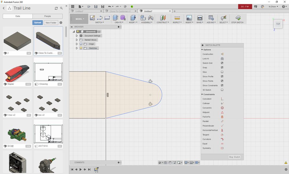

Hello Everyone.
I am very new to Fusion 360 and am trying to teach myself by working on a simple project, but am coming across an issue I can't solve myself.
I have a rectangular box made and I figured out how to fillet the edges so that I created rounded corners on one side, but on the opposite side, I want to create more of a tapered edge that goes back about 12mm from the middle tip.
Here is my quick drawing I made to give you an idea of what I want (the bottom part is figured out by using fillet with an amount of 10, but the top tapered part is where I am having issues).
Thanks in advance for any and all help.

Hi, Douglas
  I am also fully understand what the final result you want. I create some snapshots for your reference. If that is what you want. I think you can use sketch constraint to make the model like that. Sketch can make a line tangent to an arc line. Let me know if that is not you want.

Thanks for the help.  The 2 pictures you linked are basically what I am going for.
Can you give me a quick run down on how to do this?

etfrench
You can use a two direction chamfer on the end, then finish with a fillet to get that shape.

chencon
Hi, Douglas
  I am actually draw an arc first, make the arc center point with distance 12 mm and then create two line to link with them. After that I use tangent constraint applied on them. And Trim useless lines. Add fillet to round the horizontal line and line link with arc if needed.
  Trim, Fillet and Constraint are available in Sketch Mode,
  I attached a list of screen shot in sequence. Please have a reference.

OK, I didn't have time last night but had a bit this morning and went with the chamfer approach.
I think it turned out well, just had to do 3 chamfer's then fillet the edges and play with the values until things looked good.
Here is what it looks like now.
