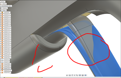

Hi! I have problem with fillet in my fushion 360 model. I don't know why it doesn't work. Is it posible to fix it without drawing again construction. I am sending screen and fushion file. Please help. 🙂FTJ.jpg

you have already stapled but still a lot of intersections that prevent what you plan to do. it makes sense to cut this thing well and cleanly and then staple it individually.-------------------- greetings mango

Your main reason this edge will not take a fillet is because you are trying to apply a fillet to a surface body edge as shown in the section analysis.  If you make the body solid you will still have a fillet issue due to the right angle end of the edge.  You will be able to apply a variable fillet but a constant one will probably not be possible until you solve the abrupt end.  You may be able to sweep a profile around the edge but that is after you fix the surface body to a solid.

that is not the reason.   surfaces can very well be rounded, but for this they have to be welded together well.

My apologies, you are correct.

This model has a number of modeling errors apart from those features that already have a yellow icon in the timeline.
