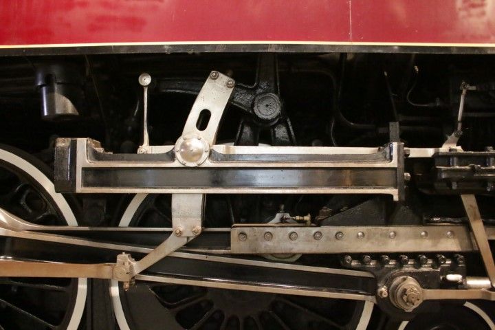

I understand that there's some complexity in what I'm doing, but that's the nature of the part I need.  I've done lot's of 3D modelling for other simpler parts - I've just used wood and a tablesaw instead of software and a printer.  It's because this part is complex that I want to take advantage of 3D printing.
Having said that, are you suggesting that it's not possible to fillet and/or add draft to the part once it's modelled this far?  Any insight as to why I can do that on one section, but not on an identical section elsewhere on the same part from the same sketch?
