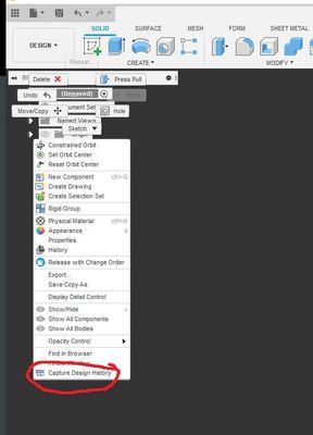

When I import an stp file in Fusion360 and create any features, they are shown towards the left hand side rather than in bottom as shown in the native files and I can't edit the features either. While sketches are captured in the tree, if I change the sketch, the corresponding feature that used this sketch doesn't change. Is there any way to preserve the history?

In the browser right click on the uppermost item and hit Capture Design History. Also check here:
https://knowledge.autodesk.com/support/fusion-360/learn-explore/caas/sfdcarticles/sfdcarticles/How-t....
Hamid
barry9UDQ6
RMB on the top level of your browser tree.
