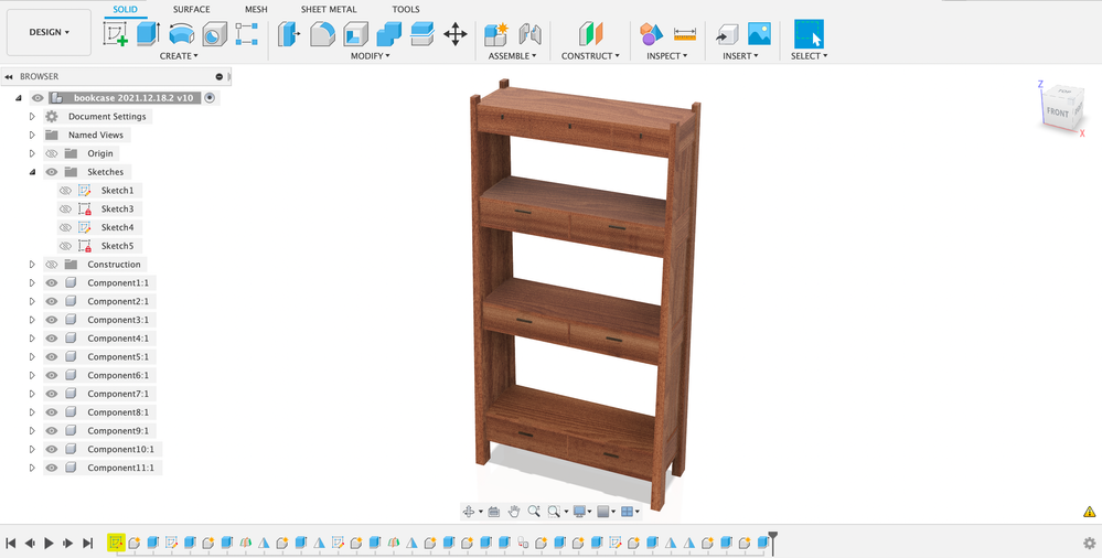

TheCADWhisperer
@avi.sato wrote:
I have a fairly simple project...
I'm wondering if it's a new bug or an old one ...
 ...they're literally drawer handles and the only constraint on them is that they're symmetrical.
I would model very differently.
1. I would model with symmetry about the Origin.
2. I would not duplicate sketch elements.  (I see a lot of duplication in Sketch1 - each geometry constraint that Fusion has to solve gets more computationally expensive as duplication increases.)
3. Components (and their instances) would duplicate the real world twin.
4. I do not see real world clearances for any "drawers" to move?
I can think of several different strategies than the file that I attached - but any strategy would have one thing in common - very simple sketches.
Use single lines and Extrude Thin Feature for planar sheets.
