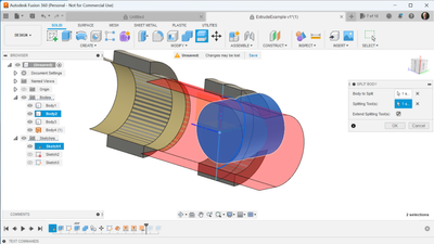

Sometimes I have to extrude a profile to min( distance, surface of a body).
It is easy when the profile is smaller to the body, I can estrude to object following its surface.
What can I do when the profile is bigger than the body ?
For example I want to extrude for a maximum of 20 mm, but make the extrusion follow the body surface without entering it.
Which is easiest way to achieve this goal ?

Just extrude "New Body".
Then combine Cut (Keep Tools).

Do you mean this?
You could create an offset surface, extend it, and use it for extrude to body.
wersy
You can also use the arc of the sketch to split the body.

The solid on the red circle is a simplified version of what I want to do. The extrude stops at the set distance in free air, but when it intersects a solid objects it stops immediately following the contact surface. In this example I can solve with two different extrusions, but I'm looking for a general and easy procedure.
