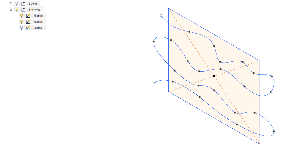

Yes. For a 1000 piece jigsaw, one extrude, Find the pattern of cuts to suit, it would be two split body commands. vertical / horizontal runs. Forum is not working for photos and other formatting, so stuck until they fix it. Construct a series of vertical and horizontal sketch cut lines, join each other end as if a snake, overlapping outside the puzzle, for the pieces to be cut. File attached. Might help....
Message 12 of 12
davebYYPCU
Forum is working for now, some pics....
Sketch 1 is the plate, sketch 2 a cutter
Sketch 3 another cutter.
Done,
Might help
