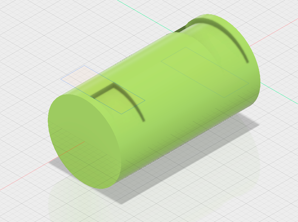

Hy all,
I was testing some engraving "things" and found an "a bit unexpected" behaviour for the Extrude from Offset if the sketch face is in a tangent plane:
Here is a sample test (see pic):    cut (extrude)  a rectangle into a cylinder side face,  if done from a mid plane sketch  it works as expected. (backside cutout)   If done from a tangent plane sketch - the extrude only cuts half of the profile (front )
(This happens also with other shapes in the sketch like TEXT what was my initial try)
Is this a Bug - or did I just misunderstand the feature?
Grüße aus Heidelberg - Michael
BTW: Below also a short screen cast to explain it in more detail.
2,161 Views
jeff_strater
Hi @mhoff67,
Yes, that is a bug.  Thank you for the detailed explanation and video.  We will look into this bug.

Update: This bug should be fixed with June 2020 release.

It's nice that this is being worked on.  It's of limited use with out the chain faces option-
Then there's the wonky behavior when the object surface curves normal to the extrude direction.  you'll note this doesn't happen on the to side of things-
https://knowledge.autodesk.com/community/screencast/eef59ff6-f8a8-489d-bfc4-69d71291eade

samuel.templeUCPAE
Would there be any way of sharing this file with me so that i can better investigate the issue?
Also, if you would be able to include more information regarding what you are trying to achieve as the screen recording isn't very clear, that would be most appreciated.
I have done a fair amount of testing in this region but would love to better understand if this is a bug or a hopeful improvement.
The more information given, the better equipped we can be in getting back to you with a hopeful remedy
