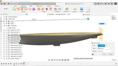

I now have the following hull where i have removed the deck and the surface on the transom. I would like to extend the deck rewards and the hull meets extends to meet this. So in effect removing the sloping transom to only have a flat one.
I have been using the extend function to extend all four surfaces but have the following questions.
1. Is it possible to extend the whole shape?
2. If i extend the hull, is there a way to draw a horizontal line to remove the excess surface area?

i do indeed and thanks for that. I'm trying to learn, would you be able to give a rough idea of the process you used or at least the tools?
wersy
I forgot to capture history first, so you don't see the offset.
Well, first offset 0,00 mm the outer hull in surface mode.
Extend the transom as needed

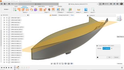

Create a plane of the deck using 3 points
Use this plane to trim the overhang

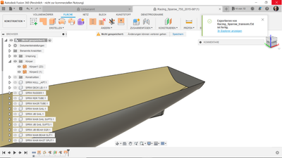

Create an offset plane to trim the transom
Trim transom
Loft the two half profiles to get the transom
