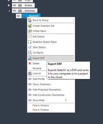

You should be able to export DXF files with the educational license. There are a few ways to export DXF files. Most people exporting for CNC are exporting sketches and you can do this with all versions of Fusion. Just right click a sketch in the browser and select Export DXF.
