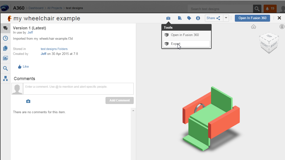

Hi @Zero__,
You can do this without breaking links.  What that error message is telling you is that you cannot export from within the Fusion client itself.  Instead, you have to export from A360.  So, open the details in A360, then choose Export from the toolbox:

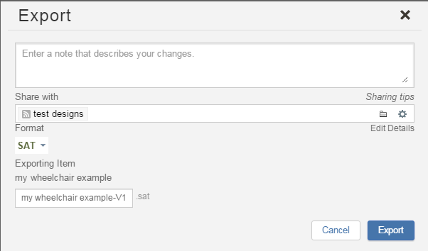

Then choose SAT as the Format to export to:
and choose Export.  This will do a cloud export to your project.  This will then appear in your A360 project, where it can be downloaded.
Jeff Strater (Fusion development)
