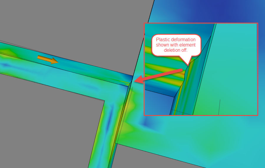

Correct me if I am wrong but you stated "i'm pretty sure it would gash through 1/2 thick plate."  I think you meant to say it would not, correct?  If that is the case then you need to turn off element deletion in the settings.  This is just another way for you to tell when something has plastic deformation or rupture of the structure could occurred.
When you turn it off, you see more expected results.
I do have a suggestion for you.
15 mph = 264 in/sec
You set the parts 0.5 inches away from each other for a 0.003 second simulation.  264*.003= 0.8 inches.  Event Simulation works best with parts starting very close to each other.  You are wasting 2/3 (guessing) of the computation time by moving parts through space so far.  You already know the initial velocities so just start the parts off very close to each other.

The element deletion feature is a very important aspect of Event Simulation, but it must be used cautiously. This is the feature that allows you to test your model all the way to the point of failure, or simulate extreme events such a bullet impacting a piece of steel armor.
At the present moment, you can only specify element deletion for Event Simulation based on maximum principal strain (we have plans to expand the element deletion options in the future). If you enable this option, the simulation solver will inspect the strain values in every individual finite element in your model at every time step to see if the strain exceeds the deletion threshold that you specified. If the threshold is exceeded, the element is deleted and removed from the simulation. One useful thing to note is that when elements are deleted and new surfaces are exposed in your model, Event Simulation will automatically handle these new contact surfaces for you assuming you had contact enabled in your study.
The problem that you're seeing in this model is that the default deletion criteria of 1% strain is too low for metal materials. Generally speaking, metal is a very ductile material that yields quite a bit before rupturing. Intuitively what you would expect to see in your simulation is the metal parts dent/bend/buckle/etc before you see a perforation develop. With a more realistic deletion criteria value, this is the behavior you will observe. To give you an idea how low the 1% value is, I noticed you chose the High-Strength Structural Steel model out of the Fusion 360 Nonlinear Material Library. This model is based on ASTM A992 Grade 50 structural steel, which has a typical elongation value in the range of 18-21%. I suggest giving your simulation another try and modify the deletion criteria option in the study settings to 0.2 (20%), instead of the default value of 0.01 (1%).
