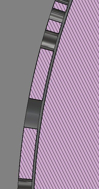

I am attempting to emboss on a sphere using the replace face tool. First embossing on a cylinder with the same radius as an existing sphere, then removing the cylinder, and replacing the face of the sphere with the back side of the emboss body. I've seen this done on YouTube with text, but I can't get it to work here with a pattern. If anyone cares to look at the file, I would really appreciate it.

You do not mention what type of pattern you are looking for?  Also, your embossed design really does not fit to the surface of the sphere since the cylinder does not have the same curve as the sphere.  You can see this in the Sectional Analysis taken off the center plane of the sphere near the edge of the embossed figure.  Model is too large to attach.

Yes, I understand that the surface of the emboss does not fit the sphere. That’s the point. I created the emboss using a cylinder, and I’m trying to use the back side of the emboss to replace the face on the sphere. Basically filling in the gap, then using a spherical cut to cut the front side of the emboss. This method works with text. I can post a file that demonstrates it.
