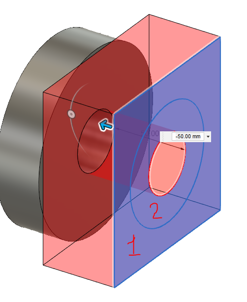

TheCADWhisperer
@RogerInHawaii wrote:
The preview looked good, so I hit OK. but it didn't do anything..
Your Preview should look more like this (select areas 1 and 2).

zodiaceng
Edit your feature and select inside the circle as well. It's only selecting the outside of the circle that was projected to the surface during the sketch creation.
