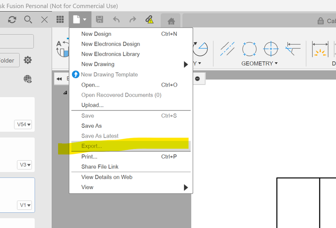

Did the free version just lose the ability to export sketches to DXF?
I used to do this, now all grayed out.

g-andresen
Please share the file for reply.
File > export > save as f3d on local drive  > attach to post.

HughesTooling
It might get blocked if you have all 10 documents open you're allowed with the hobby version.

patmat2350
Nope, not that

patmat2350
What will sharing a file do? This is a menu functionality question

HughesTooling
I probably phrased that wrong, Have you got 9 or less files set as editable?

patmat2350
9 or less, correct

HughesTooling
Pretty sure you can only export sketches from the browser using export sketch.

patmat2350
Ah yes thanks. I was wondering if I had just forgotten where the pick was- yep, I forgot!
The chances of finding clues to solving the problem increase when the facts are presented as precisely as possible. In addition to verbal descriptions, screencasts are particularly useful for illustrating processes, or at least informative screenshots.
These can then form the basis for analyzing the file in question.
In this case, screenshots were the key to the solution.
