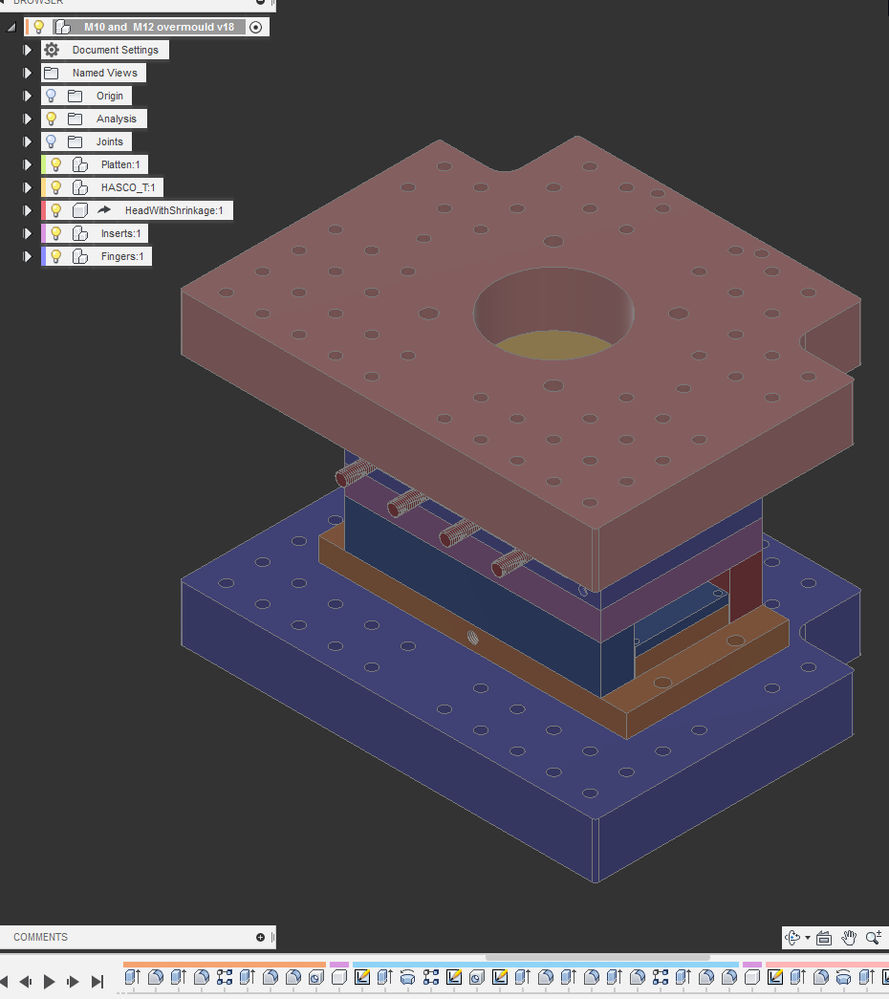

HughesTooling
Don't have the time to go into why components work for me.
Have a look at how easy this assembly is to manage, only 5 top level components.
Within these are more subassemblies, then each component contains the sketches that built it also note the timeline is in blocks where I create a component then all it's features. Easy for me to figure out what's going on and easier for Fusion to keep track and not end up slow and unstable. Maybe this workflow will not suit the way you work, you'll need to figure that out. With Rule #1 you make a component first and with it active create all the the features, you don't move bodies into a component.
The 2d drawing workspace doesn't really work well with assemblies, it has no clue about the orientation of components, really there should be an option to create views based on the component origin not the document. In more traditional solid modelers you'd create each component\part in a separate file then create drawings from the files. Fusion using Components instead of files doesn't have any way of replicating the parts in separate files workflow for drawings. Brought it up a few times in posts but never got any answers on improvements.
