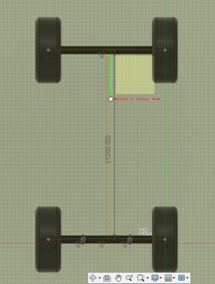

Here is my sketch:
The '(1200)' dimenion is being driven by something that I probably placed in the early stages of the design. At this point in the design, that dimension must be a 'key' demension (dictated by racing rules). I want to drive this dimension by a parameter that I have defined. However, I can't specify the value because this dimension is 'being driven'. I need to determine what is 'driving' this dimension, and make this dimension, in this sketch, the 'driving' dimension.
Message 11 of 11
davebYYPCU
Purple Geometry.  Changes to the 1200 in the previous sketch so the wheels will adjust in this one.
