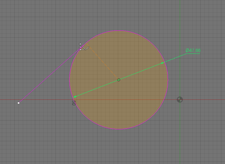

promm
@cekuhnen,
I appreciate your opinion, please keep in mind that these are things that you consider "basic".  I would also like to point out that you can constrain a line tangent to a curve by constraining the tangent handle to a line.  While this might not be the implementation in a way that you consider acceptable and it is something that I would like to improve, it can be done.  On this topic, I would like to explain that other CAD products do the same, however they automate the process and hide the point / handle behind the scenes.  As we continue to evolve our spline will advance with CV's, our loft and sweep tools will get edge continuity control and workflows will become more streamlined.
Regards,
Mike Prom

@promm
My mistake I meant to say a perpendicular to an arc or circle or spline.
I come from Rhino and Ashlar Cobalt. I started with CAD when I was 14. I am 40 now.
It makes me lift my eye brows when I see professional packages like OnShape talking about powerful design tools
and then you cannot make a line perpendicular to a circle or spline? True with a circle one could make a line coincident to the arc
and then colinear to a line that is coincident to the circles center and you added and extra line just to get this done.
And like with tangent this simply should be possible with perpendicular. We also dont draw a line from the center of the circle to the circle so we can make a line perpendicular to the line so it is tangent to the arc.
I am not stating this have to be copied 1:1. One if the main reasons Fusion is easy to teach unlike Rhino is that it is smart with tools.
