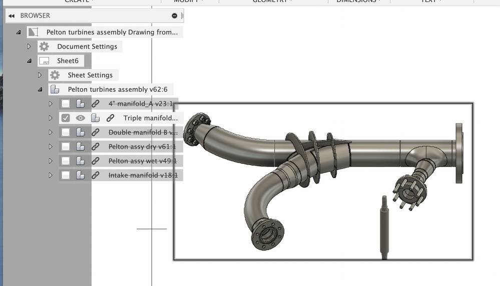

Drawing shows suppressed component
r.moss
I'm glad the December update fixed the issue with drawings getting corrupted as soon as the file was reopened (https://forums.autodesk.com/t5/fusion-360-design-validate/re-opening-drawing-corrupts-its-model-refe... ).
For some reason though my drawing now shows one of the suppressed items.
The shaft in the image is from one of the "Pelton assy" components, which are both suppressed - it should not be visible.
This is on an M1 iMac.  The shaft appears whenever I add a sheet, though for some components it lies outside the bounding box and gets cropped.

Here you are - see "Sheet6", also (just) visible in Sheet7

In Sheet7, try selecting one of the drawing views and dragging it slightly - you will then see the unwanted component in full i.e. uncropped.

The story continues!  I just changed one drawing view from edges-only to shaded and the suppressed spindle became visible.  Here's the screencast:

Sorry for late reply. I am able to reproduce both issues and have created a ticket for tracking the issue. I will update more once I get some insights into the problem
