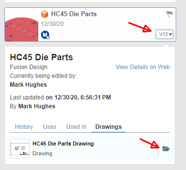

All sounds a bit strange! Don't suppose you created a milestone? Also what happens if you right click the base view in the browser and select Open? Does it open an old version of the file you've edited? Don't suppose you used Save As to create a new version of the original design?
Is there a flag on the top toolbar meaning you're using a milestone?
Mark Hughes
Owner, Hughes Tooling
HughesTooling
Also in the data panel if you expand the details of the design can you open the drawing from there?
