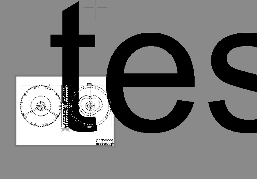

Hello, i have been trying to generate a drawing from my model and in appears that it will be quite difficult.
I prefer to work in ISO, generelly to present my drawings in A0 format.
My intention is to create a drawing which will fulfill basic standards.
I met following problems:
- although the page setup is in mm, it gives me dimensions in inch
- the dimensions are shown as giant numbers
- to add text, doesnt give me proper format
- drawing doesn¨t contain default frame.
What can I do. I need do make a drawing?
Thanks for your advices
BR
Hanachek

Hi jhanacek,
Sorry to hear you're having difficulties.  We've seen a problem in the past where some settings in preferences go blank/out of sync and the symptoms are very similar to what you're seeing.  Can you please try the following.
1.  User menu (upper right corner) > Preferences > Drawing
Are there any settings here that are showing a blank value instead of an actual value?  Possibly the Sheet Size (this would be the titleblock problem) or Font/Text Height?
2.  Click Restore Defaults (should reset to ANSI, inch, B-size sheet) > Apply/OK
3.  Close all open designs/drawings > Close restart Fusion
4.  Preferences > Drawing > Set your defaults again (ISO, mm) > Apply > OK
5.  Try creating a new drawing.
If this doesn't do it for you please let me know.
Chris Miller
