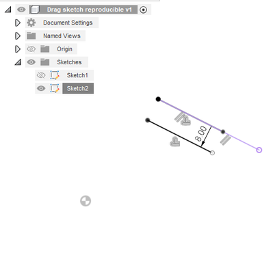

johan.rutgeerts
@TrippyLighting is correct! It is due to the offset command and the bug is easily reproducible.
EDIT: as also is @TheCADWhisperer
@jeff_strater @Phil.E see file in attachment:
  • Draw some lines in sketch 1,
  • Define sketch 2 and project one of the lines of sketch 1:
  • Draw a shorter line onto that projection:
  • Define an offset of the short line:
  • The endpoint of the offset line can be dragged, and drags the full sketch with it:
I think it must be some buggy interaction of the offset geometry with the constraint solver: in this example if you add a dimension to the short line, then it's not possible anymore to drag (see image below). In the previously posted file however, the sketch was fully constrained and still could be dragged.
