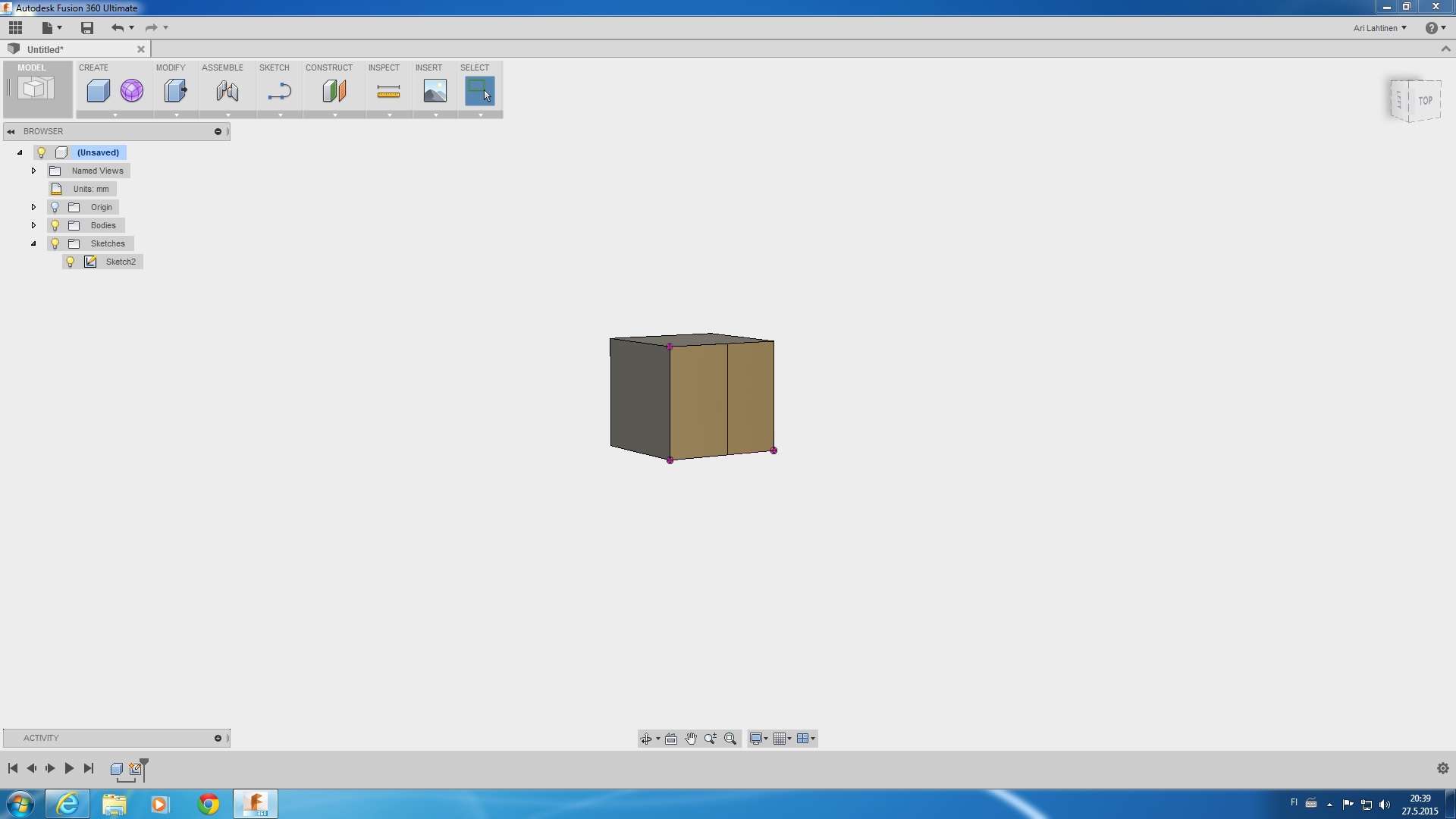

Hello and again about red dots and lines
I understand those when I create plane and project geometry onto sketch create on plane.
But what is the meaning, I draw a box and made sketch onto one of this face and then those
symbols appear on the screen (not allways...)
Thanks for answer.

I meant that I draw a symbol ( rectangle, line or something) onto sketch.
Now I noticed that if symbol touch edge of sketch those dots appears.
So I don't understand those meaning.

@alaher,
The Red Dots are the ends points of lines or arcs.
You will also see them in spline end points and points of tangency.
Please let me know if this answers your question.

I can add a few more details here, especially around the "not always" part.
As Bob says, those "dots" are the endpoints of sketch curves (and other sketch points - arc centers, even points added by themselves).  And the purple geometry indicates that the sketch curve has been projected from other geometry in the model (either by sketching on a face, or specifically using the Project command).
So, there are two aspects that determine the "not always" part - Fusion only draws the dots in certain cases, for user-created geometry:
  1. standalone points
  2. arc or circle centers
Second, for projected geometry, Fusion does show the endpoints more often, for instance if you project a face into a sketch:
There is one relatively new behavior, though, that can cause some confusion:  When you sketch on a face, Fusion does not automatically show the projected geometry from this face.  The reasons why this is done is to reduce clutter in the sketch.  Those curves are there, but just not shown.  But, when you "use" one of those hidden curves, Fusion will draw it.  For instance:
So this can cause some head-scratching, because these purple lines and points can "appear" sometimes without obvious reason.
Hope this helps clear up some of the questions about this area.

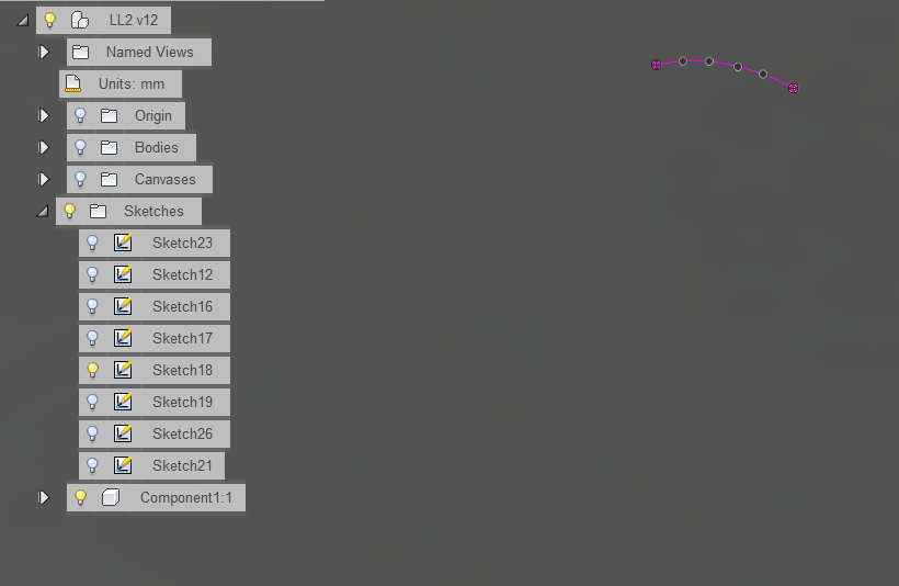

Thanks, @Anonymous.  The problem with this design is not the red dots but the fact that this profile is composed of multiple sketches.  Fusion will only recognize profiles from geometry all from the same sketch:
here is the whole model (all sketches):
And here are the individual sketches:
So, all of these curves need to exist on one sketch for them to be recognized as a profile.
You could use the Project command to project them all into a single sketch if you don't want to redraw them
Hope this makes sense,
Jeff
