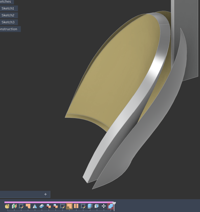

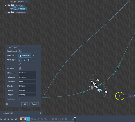

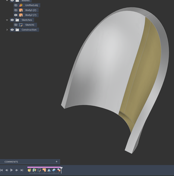

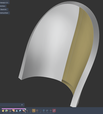

Hello. I don't understand why this doesn't work.
1) I created a 3D sketch with a closed 3D profile
2) Patched it
4) Thickened it
5) Deleted the outside face (created by "Thicken") to re-patch it with a center rail, in order to create a bulge in the thickness of the model → finished with other operations.
6) Went back to the original sketch and moved (as an experiment) an unimportant CV from one of the original splines by an unimportant amount: 1mm. → the patch broke.
I come from 4 years of direct modeling and always avoided parametric because it was a stick in the wheel the entire time to say the least. For the more parametric-like things I preserved sketches and re-lofted as needed. Deleting surfaces is very important because in that way I can re-surface, varying the shape of objects, or insert foreign component into surfaces harmoniously by cutting the surface with a curve, then deleting the middle face, then lofting, filleting, etc.
This is not working, I have to do that operation. Please give an (or any) advice...
Pictures (in book-style order): the final object; editing the first sketch; the broken object; the related warning.

Thank you. Still there are mysterious things happening here that I don't understand (and therefore can't fix). Can you check this? ↓
Incredibly, after moving that "most unimportant" CV by that "most unimportant amount" (1 mm), after re-patching (successful), re-thickening (successful), at the moment of the deletion of the external face, THE INTERNAL FACE IS DELETED INSTEAD. Why? Subsequently to that everything downstream fails.

Not equipped for screen-cast at the moment. But you can see that the sequence of the first features is already mind-blowing. I have a fully closed 3D sketch, patched, mirrored, thickened, then deleted a face. Then as an experiment a random CV belonging to the first sketch was moved of 1mm. Result: the wrong face is deleted.

When you mirror the 1st patch, the two surfaces are not tangent, and that is ultimately the problem. The issue here isn't the parametric nature, but your modeling technique.
I would create the central sketch as a 2D spline on it's own plane. Then you don't need a sweep, you can use a simple surface extrude.
