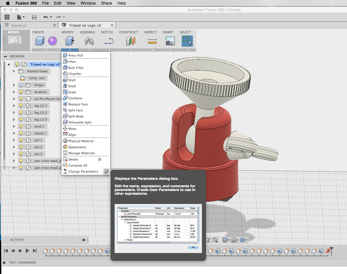

promm
Philip,
Happy to help.  Can you add me to the project, mike.prom@autodesk.com or email me a exported .f3d file so that I can take a look at how you modeled them?  With out looking at your model I would advise you to look at your parameters.
If you make each of them separately you will be able to edit the length parameter of the third angle without affecting the other two.
