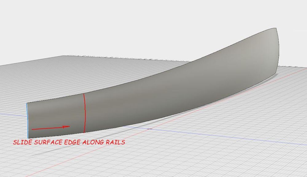

Hey F360 crew!,
Is there a way to slide the surface edge/profile along the rails?  This would be handy when overbuilding the surfaces for future trim operations. I have seen this feature in Alias Surface.  Any chance it's hiding somewhere in F360?
Cheers,
Jack
Slide surface profile along railsSlide surface profile along rails
632 Views
davebYYPCU
You can extend a surface - the left hand direction, never tried your example, extend negative
If the rails are projected into the profile ssketch,  then yes you can move the profile sketch plane, with edit feature, I would not use redefine sketch plane for it.
it is more common to split face or split body.
Might help....
TrippyLighting
Nope, that's not hiding anywhere in Fusion 360. Just for clarification, if it comes to surfacing Fusion 360 does not nearly have the power Alias has, but on the other hand in the cases Fusion 360 creates acceptable surfacing results is't much faster to create it in Fusion 360 than in Alias.
