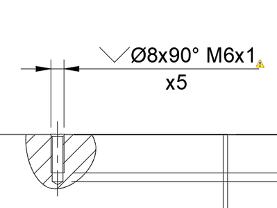

The thing that breaks pretty much every time I update anything is the hole callout.
Because Fusion refuses to automatically put hole call-outs on normal dimensions and insists on doing it with leader annotations instead, I am forced to manually type those callouts into the dimension (and yes, you can't even copy/paste from an automatic leader annotation for some reason unbeknownst to me).
And this thing just breaks almost every time you have to update the model for any reason.
Also I am totally not satisfied with automatic hole annotations. I may be wrong or I may not understand something but doing drawings for 18 years I never wanted to put a hole callout on an leader note like Fusion suggests I should.
This is wrong:
This is much better:
Reason being I don't want to rely on a overcomplicated convention to let people know how deep a hole I need with how much thread. And I want to be able to tolerance the hole depth and thread depth the way I need them. So I would much rather provide manufacturers with a proper seciton view with proper dimensioning. In some places this is a requirement to section all blind holes for clarity.
I my mind - the more obvious you make a dimension, the less chances someone would screw it up.
Usual questions:
Am I doing something wrong here or is it just Fusion? Why does it keep loosing references?
Is there any chance to get a tool that would put a hole callout on a normal dimension and also let you customize how much stuff you actually want on that callout?

For the first part, regarding dimensions losing their references: from what you’ve described, it doesn’t seem like anything that should cause references to break. To help us dig deeper, could you please share the data set if possible? That’ll help us check exactly what’s going wrong. Also, does this happen consistently across multiple models or just this one? Also Can you please confirm this disassociation issue is only with manual created dimensions  or only with normal placed dimensions?
As for the second part -the hole callouts — right now, Fusion doesn’t support placing hole callouts directly on regular dimensions, only through leader annotations. I agree this isn’t ideal, especially when you’re trying to control tolerances and keep things clear in section views.
I’ll double-check with the team on this. IMO, this sounds like a good candidate for an enhancement request.
