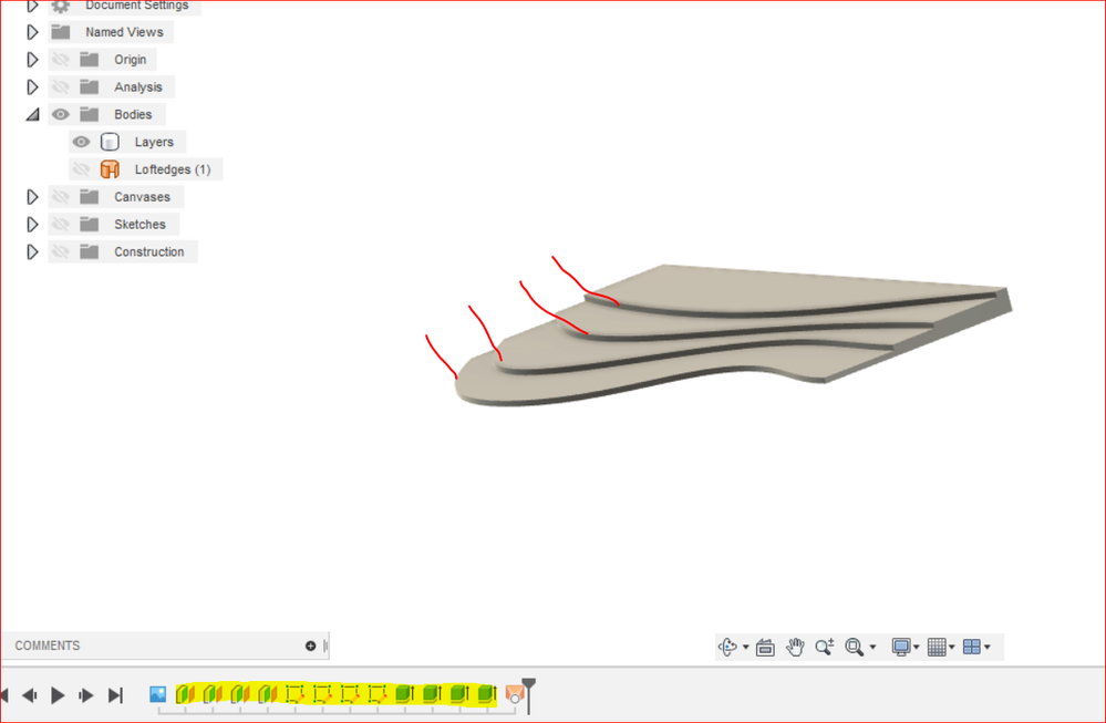

Cant read the height levels - so made them up.
Draw your block outline, and then add construction planes, for the levels you want to sketch on.
Project > Project, the block edges to use and plan points, for the height you are currently working on. Connect the dots with a spline, making sure the spline overlaps the block outline.
Plane and sketch for each layer.
Then Extrude the sketch profile, to the next layer.  Repeat.
When you have the layer cake, you change to Surface, > Loft and select the extrude edges (not the sketch lines, because they have to overlap the block.
If you have tight curvature between the contours the loft may fail, these curves worked out ok, but as you see, the colour highlights the areas that may show up with your set of numbers.
Demo file attached, step up the timeline,
Might help...
