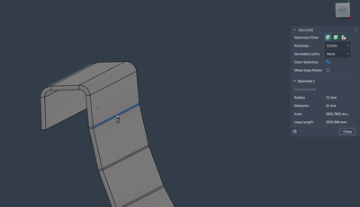

I modelled a sheet metal piece, but it has different inside bend radius.
I used the same stainless steel rule with a thickness of 3mm and an inside radius of 4.5mm.
The down bends are inside radius 4.5mm and outside 7.5mm = correct
The up bends are inside radius 7.5mm and outside 10.5mm = wrong, should be 4.5mm and 7.5mm also.
This behaviour is new to me, I am afraid that the part won't bend correctly.
Can anyone explain me why this is and how I can fix it?

GC_CC
Interesting...
I chose side 2 in my original design and get these radius when I make a bend table (as I said all the down bends are OK):
When I switch to side 1 I get this table:
Almost all 4.5mm but one is 7.5mm... wierd
Update: When i choose Center I get all bends 4.5mm, so strange
Is there a way to solve this without having to draw it again

johnsonshiue
Hi! I could be wrong but I think the Lofted Flange cannot guarantee consistent Bend Radius across the entire body. It depends on the faceting tolerance and the geometry. In this case, the upper left Bend on Side 1 has 7.5mm Bend Radius, because it transitions from a vertical line to an arc. 4.5mm does not offer enough room for such change. If you edit Sketch 5, trim off the arc a little bit, and add a short vertical segment, I believe the Bend at the corner will have 4.5mm Bend Radius.

GC_CC
I designed the part again and used the lofted flange feature with orientation "Center".
I have the exact same overall dimentions, but now it used all inner radius of 4.5mm.
I don't really know why, but it worked. Thanks @Warmingup1953 for the hint.
