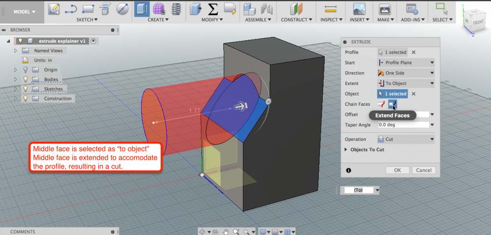

For now, since there isn't a good help page, here is a graphical explanation of the extrude options.
Min solution.pngmax solution.pngchain faces.pngExtend faces.pngextend join.png
Please let us know if you have any more questions.

Message 11 of 12
kb9ydn
@Phil.E  That's a much clearer explanation; big thanks for that!
