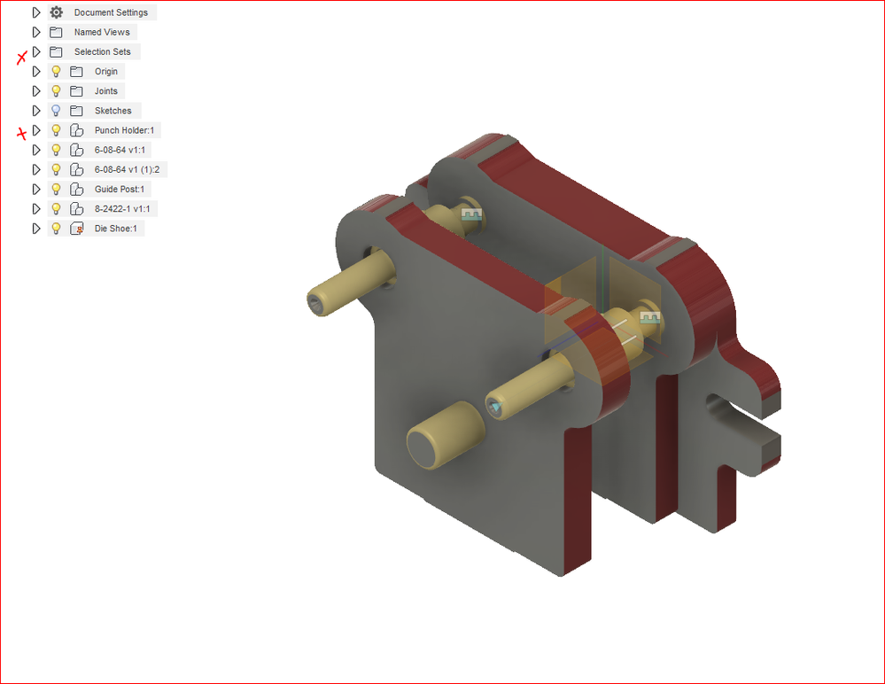

I need some help with this design, and I think I messed up some of the motion and joints.  I've tried several things to fix it including deleting and re adding joints.  I can add a public link or a .f3 file to anyone that would like to help me figure this out where I went wrong.

The Guide Posts must be rigid joint to the Die Shoe.  The bushings in the Punch Holder must be rigid to the Punch Holder.  The motion and assemly is the guide posts fit through the bushings plus are a slide motion up and down the guide posts.

davebYYPCU
Unground the Punch Holder.
Delete Contact Sets.
Animate model now works, but you will now need some Joint Limits.
Might help....

the only motion I can seem to get is that the punch holder kinda shakes about.  I can't seem drag or animate the sliding motion.  Maybe I missed something.  No matter which joint I right click and select Animate Joint, still just shakes it all about.  Maybe the wrong joint types. ??

Sounds like you are animating a rigid joint.
You need to animate the Slider Joint, with Animate Model, last option in the list.

Found it (Animate Model).  For a long time I only saw Animate Joint.  Would be more helpful if the Animate Model would be in the top level.
