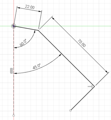

I have difficulties in creating a sequence of segments.
In Sketch, I draw the first segment, then, before drawing the following segment, I try to assign length and angle; when I do that, most of the times, the first segment turns from black to cyan and  the following segment looks to be an arc, not a segment, also cyan.
I feel I am doing something wrong with the mouse: which is the correct way to do that ? Where can I find information with the correct use of mouse ?

it is hard to say for sure without a video, but, if you are getting an arc out of the line command, it means that you are doing a drag with the mouse, from the endpoint of the first line.  The line command in Fusion is a "click first point, click second point" interaction to get a line segment.  If you "click and drag", and if your click start point is on the end of another line, then you get an arc.  I can add a video if this is not totally clear.

Make sure you are doing click-click for lines and not click-drag (unless you want an arc rather than a line).

sorry, but I am not sure what you are asking.  Perhaps a screencast or video would help.  If you are dragging an arc in the line command, there is no way to input length/angle/radius, etc for the arc.  You will have to do that with dimensions afterwards.  Only the line allows you to enter length/angle.  Here is a screencast, but I suspect you already know everything that is in this screencast:

What happens if you add this 45° (or other) angle dimension?
I suspect that the issue is that you are attempting to add dimensions "on-the-fly" as you create the geometry.
This works for limited sketching, but for most sketching you will probably add the desired dimensions after sketching.
You are sketching in the literal sense of the word - then add parametric dimensions to define the geometry.
I recommend creating one line, rectangle, circle or arc and dimension immediately for a sense of scale for the rest of the sketch.  Then you can sketch and add geometry constraints and dimensions as needed.

thanks for the video link, @Anonymous - the topic at that point in that video seems to be pretty straightforward line creation with dimensioning during creation.  But, it is still not clear to us where you are having problems with this.  Can you record a video of yourself interacting with the line command and show where you have problems?  You say you get an arc - the only way to get an arc is to drag with the mouse from the end of another line.  If you stay away from drag interactions, and instead use mouse clicks, you get only line segments, which can be dimensioned on the fly, or after the fact.  It is not clear where you are having problems.  We'd like to help but so far are not understanding the issues yo are encountering.

This is the .f3d file: to me, it looks OK.
Thank you.
