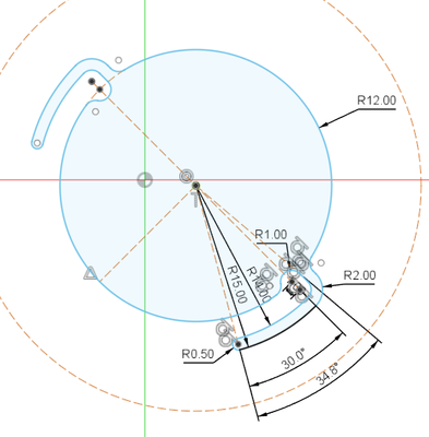

I have seen these in some different designs but can't seem to figure out the proper way to design them based dimensions' and constraints and looking for advice even video tutorial that can guide the through them.
I think part of the problem is I don't know what they are called. Any help would be greatly appreciated, not looking for someone to do the work for me, teach me to fish so to speak.

This geometry is rubbish - we will only use it as reference to recreate proper geometry...
My first step to use as reference is to move it to symmetry about the origin (roughly).
This geometry is much better, but it too is not located with symmetry about the origin and is missing constraints and dimensions.
It will be easier to fix this one, so we will start with it.
Message 8 of 44
TheCADWhisperer
@condrovic1980
Edit the sketch and add these dimensions...
Add Construction line from center of circle to midpoint of line.
Add Perpendicular Constraints.
After we get this all defined, we will start from scratch to demonstrate how it should have been done.

Now add these dimensions...
Now that we see many of these arcs are R1mm, delete all but one of the R1 dimensions.  Replace them with Equal (=) Constraints between the dimensioned arc and the other equal size arcs.

Thanks for the instructions I will give it a shot but I think I explained in correctly what I was wanting learn how to do.
Here is what I was looking for
1. Design just the center circle with the little arms nubs, but parametric so it can be adjusted based on a diameter of the circle, the idea for this part is that it's cut out of a solid part and another part will fit into it giving it some resistance based on the little nubs
I have attached a new file with an edited sketch I hope that makes sense

Here is what I have so far, the problem I seem to be having is designing the arms that come off the circle and keeping them constrained the correct way.
Message 15 of 44
TheCADWhisperer
We will get there - but you will have to follow my steps precisely.
Your sketch should look like the image below...

I can't click it currently assuming that it's due to the current constraints, which if I delete and try and add a midpoint to it does this
Message 19 of 44
TheCADWhisperer
@condrovic1980
Logic.
Observation of behavior.
Message 20 of 44
condrovic1980
Okay yeah that makes sense thanks for the video, helped a lot, I def learn better seeing it done and then replicating it, always been a visual learner.
