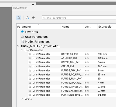

Eric_Evans_a_GiroDisc_com
Parameters as they exist inside File B:
Derived into a "New Design":
*Note they are all appended "_Ref"*
Inside File C:
All that exists are the parameters I made inside of this file
None of File Bs parameters have been imported, they would be appended "_Ref" like in the previous screenshot
In the first screenshot you can see they are Favorites.
If I Derive File B into a "New Design" they are imported as expected.
They are not importing into my "Existing Design" File C when I use the Derive command.
