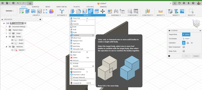

What you want to do is use the imported connector as a cutting tool to remove the parts of your model that you
don't want. This should be able to be done with the Combine Tool.
When getting rid of unwanted bodies, the preferred way is to use Remove so that if you need to come back later
and fix something then you can. If it is Deleted - its GONE.
