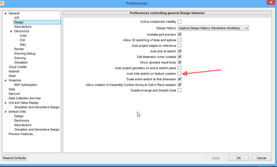

HughesTooling
There's an option in preferences to hide the sketch after it's used in a feature. Don't think using it for a move would hide it though and as a sketch has noting to do with a combine it's not going to be hidden after a combine either.
Pretty sure the default is set to hide the sketch, personally I have it unchecked/

HughesTooling
Just like to add, I uncheck the hide sketch option because I quite often want to reference a sketch in a later sketch so just find it quicker to leave it visible. It's easy to hide later, just right click on a profile or curve and pick hide from the right click menu.
