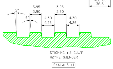

Is it possible to create a thread file where the root and the crest have different widths?
I have:

This of course creates a symmetric thread
This is used for geotechnical stuff and it is bases on the DIAMOND CORE DRILL FITTINGS - COMMERCIAL STANDARD Diamond core drill fittings (PDF)

Thank you for the prompt reply! I have tried using your software before, great stuff! Thanks for sharing. I could not figure out how to do it though.
I "think" the threads are based on the Diamond Core Drill Fittings Commercial Standard CS17-47 and converted to metric.
On the picture below, the part on top was drawn before I was born, the one on the bottom I modeled myself, but it was very time consuming with a spiral, that is why I want to create the thread data and share it with the rest.
 Bottom one I have createdBottom one I have created
And below is the roughly translated original drawing:
Thanks for the help!! ❤️

Ok, having played around with this a bit more it looks as if you won't be able to achieve exactly what you want with the thread tool. Here's a sketch conforming to the dimensions in the drawing snippet you provided:
Note the pitch should be 8.467mm (3 TPI) rather than the 8.20mm in the thread file you posted so I've corrected this. Also note that to achieve the crest and root widths that are within the limits specified, the pitch diameter has to be smaller than the minor dia. Unfortunately Fusion doesn't seem to like this situation and alters the minor diameter from the specified value in the thread file, which as a consequence alters the root width as well:
The closest I can get is if I set the pitch diameter to the same value as the root diameter:
Here's the thread file I used to achieve the above.
