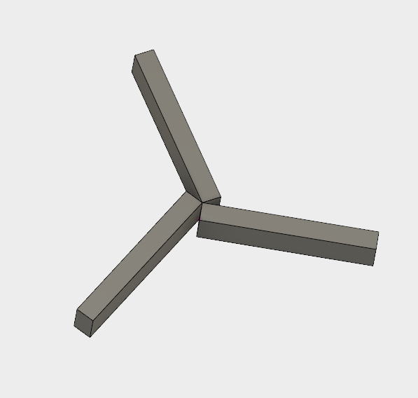

I tried another approach - to pattern the sketch and create an Extrude for each sketch pattern instance.  You do get the random effect this way:
But that, of course, is tedious to create.
That's about the best I can come up with on a Saturday morning
Jeff
