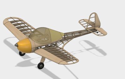

Hi Dave. Thanks for your reply.
I have already had some success towards meeting my goal by working within Rhino3D, which a friend of mine has. I borrowed his PC for some time, but it's since been returned, so am looking to my own installation of Fusion 360 to achieve it. I have attached an image I captured of a model of a Piper Skycycle I created in Rhino and then ported over to Fusion. It's not perfect, but by and large I am happy with it. However I haven't been able to emulate the results directly from within Fusion - as you say, it doesn't follow the same rules.Piper Skycycle 002 v5.jpg
