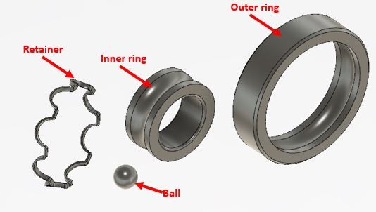

Hello everyone
Thank you for your inputs. I was actually trying to work on a simple bearing assembly in Fusion to figure out how it deals with assemblies. Below is a picture of what it all looks like. The inner ring is grounded.
So the first thing I was trying to do is to mate the ball with the curved surface of the inner ring. In Solidworks what I would generally do is apply a 'coincident' mate between two reference planes (originating from the respective coordinate systems of the inner ring and ball) and then apply a 'tangential' mate between the curved surface of the ball wit that of the inner ring. Here in Fusion, I tried creating joint origins on the surfaces but obviously I am doing something wrong. Since, as has been mentioned here by others, Fusion's workflow is quite different, I was wondering what would be the smartest way of achieving what I described in 360. I am also attaching the f3d file here for reference.

jeff_strater
Here is how I would approach this:
Note, this was a pretty quick-and-dirty attempt, and if I took the time to get some measurements and parameters, could probably have done a more exact job.  But, this gives you an idea how to use Joints and Joint Origins to assemble stuff.  It is a different approach, I'll grant you, but I've found that once I get used to it, there is little I cannot do with a joint.
Jeff
Jeff Strater
Engineering Director

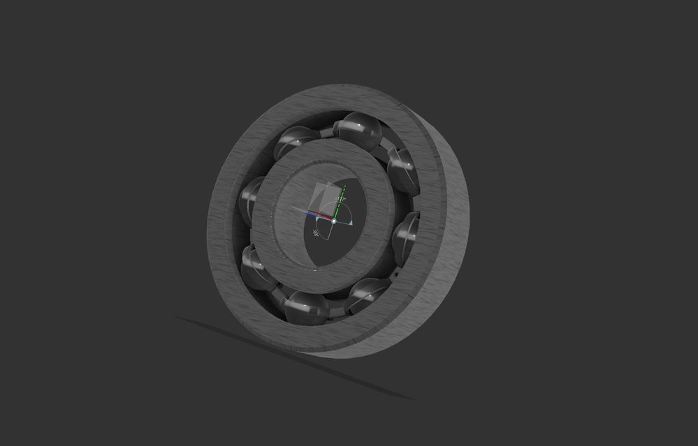

jasonhomrighaus
Here you go,  just use the joints and point to point. Even threw in a Motion link so it looks correct while rotating
