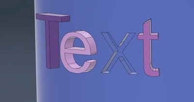

Hello all,
I have successfully embosses text on a cylindrical object which I plan to 3D print. What I'd like to create now is what I would call in-fills for those letters so I can print those in a different color, thicker than the emboss itself, and stick/glue them in the embossed text. Think of a kid's letter puzzle where the letters come out and can be put back into their respective spots (see attached puzzle image.)
My question is, how can i create the letters that will also wrap around the cylinder, matching the emboss that's already in place, including the curvature of the cylinder? My only thought is to create a new cylinder object, apply the same letters as a deboss, then get rid of the cylinder and leave the letters as separate objects that I can print. I have to believe there's a better and/or proper way to do this.
1,120 Views
TrippyLighting
If you go through the timeline of the attached model it should be clear. If not, please ask questions!
kirchash4
Awesome! It certainly does. Thank you so much!
