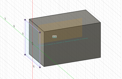

d00158431
I was able to convert my sheet metal bodies into components by making one new body around the sheet metal and hollowing that out like a mold. I created a second new body around the "mold" and used modify/cut to create a new body-- there was even a check bock to turn the final body into a new component. The excess pieces in the new component had to be removed, but I couldn't do a simple push/pull on the faces. I had to draw a new sketch and cut them away. You can also just turn off the visibility on the unwanted bodies.
