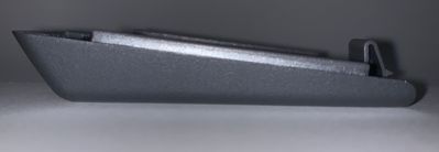

I'm new to Fusion 360 and am trying to design a replacement battery cover to be 3d printed. I was able to draw it as separate components, but couldn't get them to join together to print, so only the bottom printed.  What's the best way to go about creating a design for this irregular shape?

Is there a logical reason that you did this as multiple components?
(The image looks like one plastic component.)

I think the first problem is conceptual.  This is not an "irregular shape".  approached that way it becomes easier to see how to build it.
and you definitely don't need to move to surfacing yet.
play with the attached.  go through the time line.  adjust dimensions.  comeback with questions

@laughingcreek This is incredibly helpful, thanks.  Rather than just adjust dimensions, I'm going to try to create this again following your example, but I'm not sure how you created the plane after Sketch 2.  Can you explain that step?
Message 13 of 14
laughingcreek
sketch 2 sets the angle of the top.  the "plane at and angle" uses the angled line in sketch 2 for it's input.  sketch 3 is placed on that plane.  adjusting the the line in sketch 2 will adjust the angle of the top.
