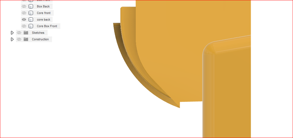

I'm a first time user with a relatively complex drawing.  I've posted a couple of times, learned a lot and thankful for the advice so far.
The current issue is conceptually simple:  I have a completed* drawing and I'm making the cores.
No problem with the internal ones - red and orange in the picture.
I now want the orange core to extend to the arm at the back.  Conceptually, it means starting at the parting plane and extruding back until hitting something in the grey.  The complication is that it:
- should have a draft angle much higher than the pattern itself,
- give the variable distance to the part, that draft angle needs to vary,
so I can't just extrude the sketch that made the arm in the first place.
I've managed to come close by various loft, extrude and taper commands.  There's just a few tiny voids left that I can't seem to manage.
I did think about extruding the sketch then adding draft, but draft only goes from a planar surface.  What I need is essentially that the draft starts at the arm and goes forward.
There has to be a simpler way of doing this, but any advice would be welcome.
* still two corners I can't fillet at the base of the ribs.  Weird considering the other 6 went fine.  As a last resort I have some old wax fillets I can use on the printed part.

You are over thinking the problem. You can simply extrude a body and with a few cuts you can extend the core to the bracket.

Does this help,
Using your geometry, and Surface Extend, you can boundary fill inside the casting,
Some Combine ops and I think I have what you wanted.  Double check for draft interference, I didn't build the gray bits.

Thank you both for your replies.  I have what I need, and more importantly, I think I understand both approaches and what I needed to do differently.
WMHAZZARD - Perhaps you used a file from a previous posting of mine?  I had tried the approach you showed, and I can see it worked with the file you used, but I needed it with fillets and draft included.  Especially problematic were the fillets at the outer edges, as the core should extend to the base of the fillet, not the face of the ribs.
I do concede that I'm overthinking the problem and that, with some adjustments your method will work equally well with fillets in place - I would just need to move the cut planes to the corresponding locations.
I also noticed that you adjusted the draft angles where the core overlaps the hub.  Good catch; I hadn't considered that.
davebYYPCU - This was exactly what I was looking for.  I had briefly looked at boundary/fill but didn't learn enough about it to make it work.  Thanks for fixing it.
You mentioned that you didn't check draft angles and, given WMHAZZARD's approach including his adjustment to the draft angles, I'm now concerned that I missed a spot.  The area beneath the hub and between the ribs may have a negative draft.  I'll have to check. It seems complicated at first, but with what you've both shown me, I think I could sort that out now.

The last step in my design is to join the rear pattern with the rear core to give a single unit for printing.  When I try, I get an error.
I've played with the section analysis tool, but I didn't find anything unusual.  Further, the core was (mostly) made by using the part as a cutting tool, so they should be a match.  Any ideas?

I offset the faces of the core prints by .01" all the way around to give clearance for the core pieces.
I am not sure why the pattern and core won't combine but don't worry about it, just save both in the same STL file and slice both at the same time, they will print as one.
It is also a good idea to over build your core prints like I had in my example, it will avoid problems like the sharp edges of the fillets on your core.
