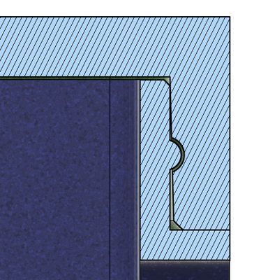

Here is another example.
Note the Face Draft added for clearance.
Can't manufacture perfect geometry.
