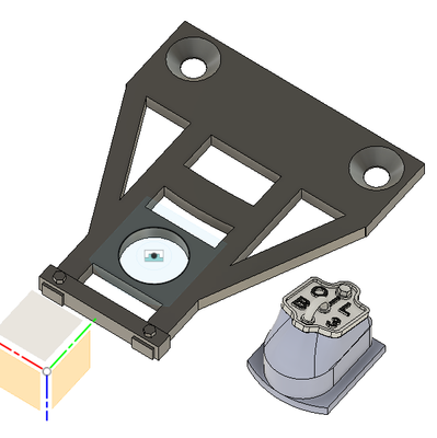

Good day folks.
I am trying to assemble two components together - a W-iron and an Axle box.
Having created the snap points, the two elements move together:
However, as soon as I click on 'OK', they move apart but the joint icon is shown in the correct place.
What am I missing?
I attach the design file.
Thanks in anticipation.
Keith

Is the component grounded to parent?  If so, it will revert back to its original position.

A picture of the expanded browser showing all of the components will show whether or not ground to parent is involved.

I selected the moveable item (Axlebox and lid).  I received the
'Existing assembly relationships' dialogue.
The problem is that I do not understand the implications of this message
or what is the appropriate action. What is your advice?
K..
PS.  I decided to take the bull by the horns, select 'Ground to Parent'
and see what happens.  It turned out to be reversible so that was a
relief. More so as in fact the axle box moved to the correct position
and remained in place.    Now printing a trial piece.
Thanks for the help.
Message 10 of 10
Jaeger1787
The trial print came out satisfactory, so Günther's suggestion solved the issue.  Many thanks.
