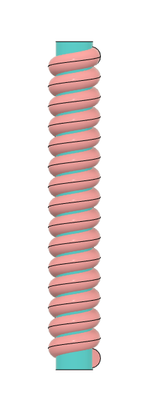

I'm trying to re-create this object in Fusion 360 and i'm completely clueless where to begin. It is a vertical feed screw for marbles to travel up. I've tried using the coil tool but i can't get that nice double helix shape.
Any pointers on how I can achieve this?

Start with a coil with a circular section size of  your marbles (plus a little clearance):
Model a cylinder with the major diameter of the desired thread:
Combine/Cut the coil from the cylinder(The cylinder must be longer than the coil).  Trim the ends.

Thank you!
